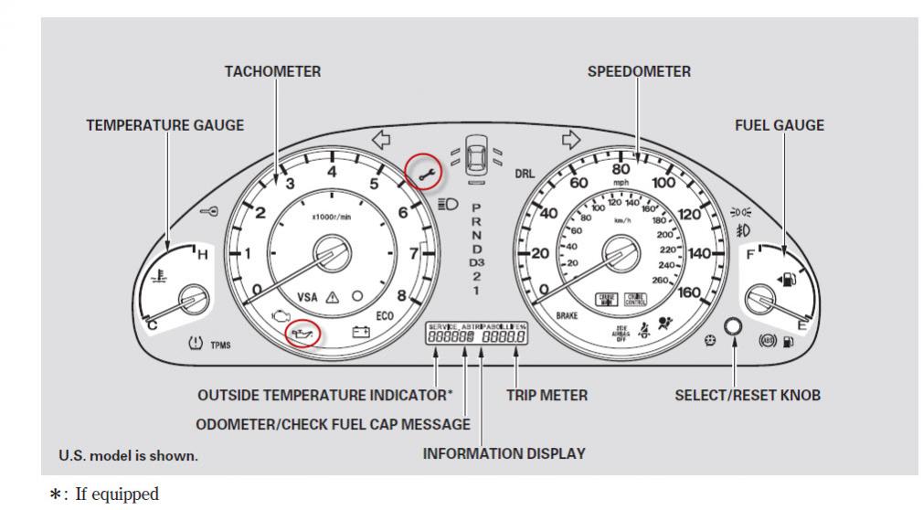

Which light is flashing? Is it the wrench symbol, oil can symbol, or some other light?

Its Oil Can Symbol which flashes whenever I hear gar gar sound. and I notice this sound only when the car is in lower gear.

That is the low oil pressure indicator warning. You may want to get the car scanned for pending trouble codes, even if the Check Engine Light is not on.

That warning light is for oil pressure, not oil level. So the oil level must have been sufficiently low that the oil pump wasn't getting oil from the pan??
The oil-life calculation is NOT any kind of measurement on the actual oil. It's a calculation based on your driving habits, how many times you start the engine, how many winter starts, how many times you run up to high RPM, things like that.
The oil-life monitor IS NOT A SUBSTITUTE for checking the oil level with the dipstick.
