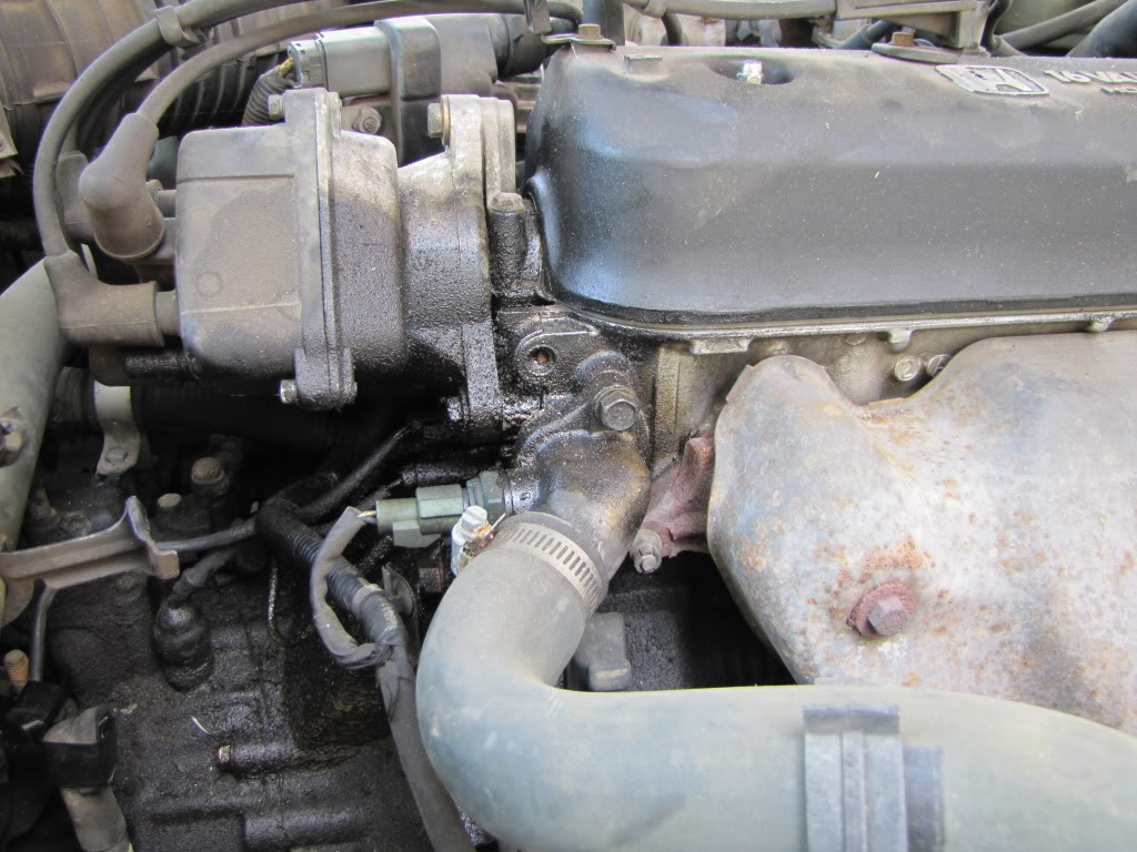

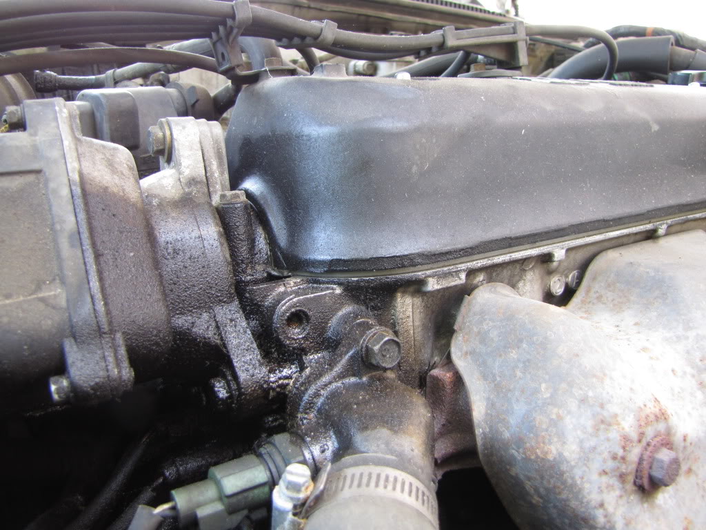

Contrary to my name and my original thought, my car is actually a 93! Yay!
Now to the oil leak. Wondering if this is the valve cover or a gasket on something else?
http://uscloud5.pogoplug.com/svc/fil...716_224054.jpg
http://uscloud5.pogoplug.com/svc/fil...716_224027.jpg
I made them just links because they are big pictures

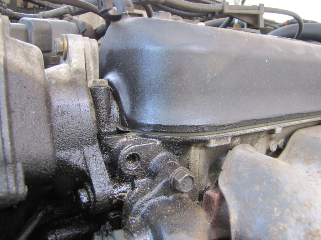

More Pictures
http://uscloud5.pogoplug.com/svc/fil...v/IMG_0128.JPG
http://uscloud5.pogoplug.com/svc/fil...v/IMG_0129.JPG
http://uscloud5.pogoplug.com/svc/fil...g/IMG_0133.JPG
If you save this picture and zoom in on the valve cover gasket you can see it pretty well. I am hoping someone can help me diagnose based on these pictures.

Is that a missing bolt there? Could that be the problem?
Old Jul 18, 2012 | 07:43 AM
Looks like leaky valvecover gasket and/or distributor O-ring.
Old Jul 18, 2012 | 06:31 PM
X2, I will say the vc gasket "looks" pretty new - along the front of the motor, nice and clean. Might be able to pull it and add a "dab" of silicone to the cam humps. Be sure to not over tighten the vc bolts, only like 9ft lbs....less than a spark plug.
My first thought was the dist o-ring.........but that is me
