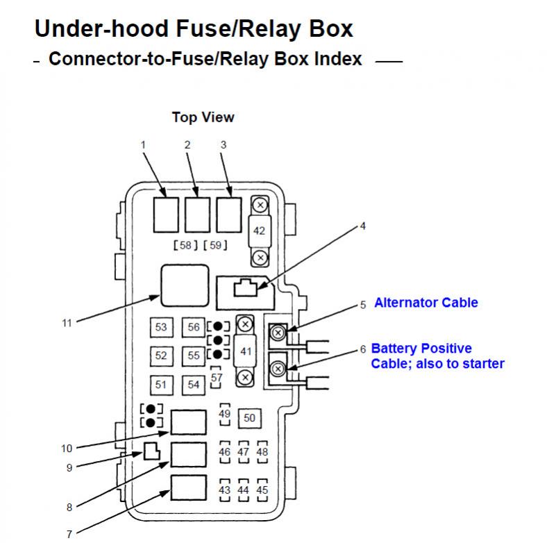

Check the condition of the alternator output cable (#5 in attached image) that is attached to the under-hood fuse box. This is alternator cable (B cable) that supplies current to the battery.
Measure the alternator voltage output at this cable with the car on.
Attached Thumbnails OK, I'm stumped. Code 1298 ELD voltage high. New alt not charging. [Solved]-under-hood-fuse-relay-box.jpg
