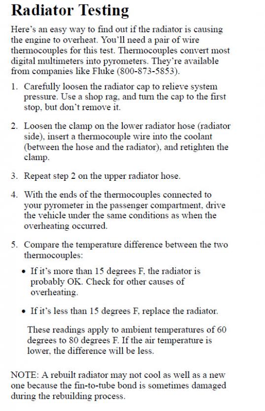

Based on the service manual , the Honda OEM thermo-switch A normally switches on at/or between 194 to 205 degrees F, then should switch off 36 - 45 degrees lower than when it switched on. If your normal operating temp. is 210 degrees F, you appear to be running on the high side of normal.
Honda use to have a test similar to this to check whether the radiator was the problem (I do see that you listed the radiator was replaced though). Get the car up to normal operating temperature, with your infrared temp. sensor, compare the temperature difference between the upper and lower radiator hoses. If there is more than a 15 degree F difference, the radiator flow is okay, if less than 15 degrees F, then the radiator flow is not okay.

I did that test redbull and the temps are within 2f of eachother.
Old Jun 1, 2012 | 04:52 PM
  #48
I looked at the notes again, and the check is done under the same condition when overheating occurred. The attached are older instructions before the advent of now commonly available infrared temp. sensors where they used thermocouples.
