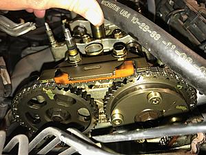

So I pulled the valve cover etc and took a quick glance.. Chain was intact- things looked good. I set the engine to TDC It looks like the chain jumped-a lot (see pic)

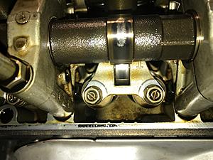

Before I continued the teardown I inspected gears and both cams.
The intake cam looks perfect with almost no wear. The valves are way out of adjustment.

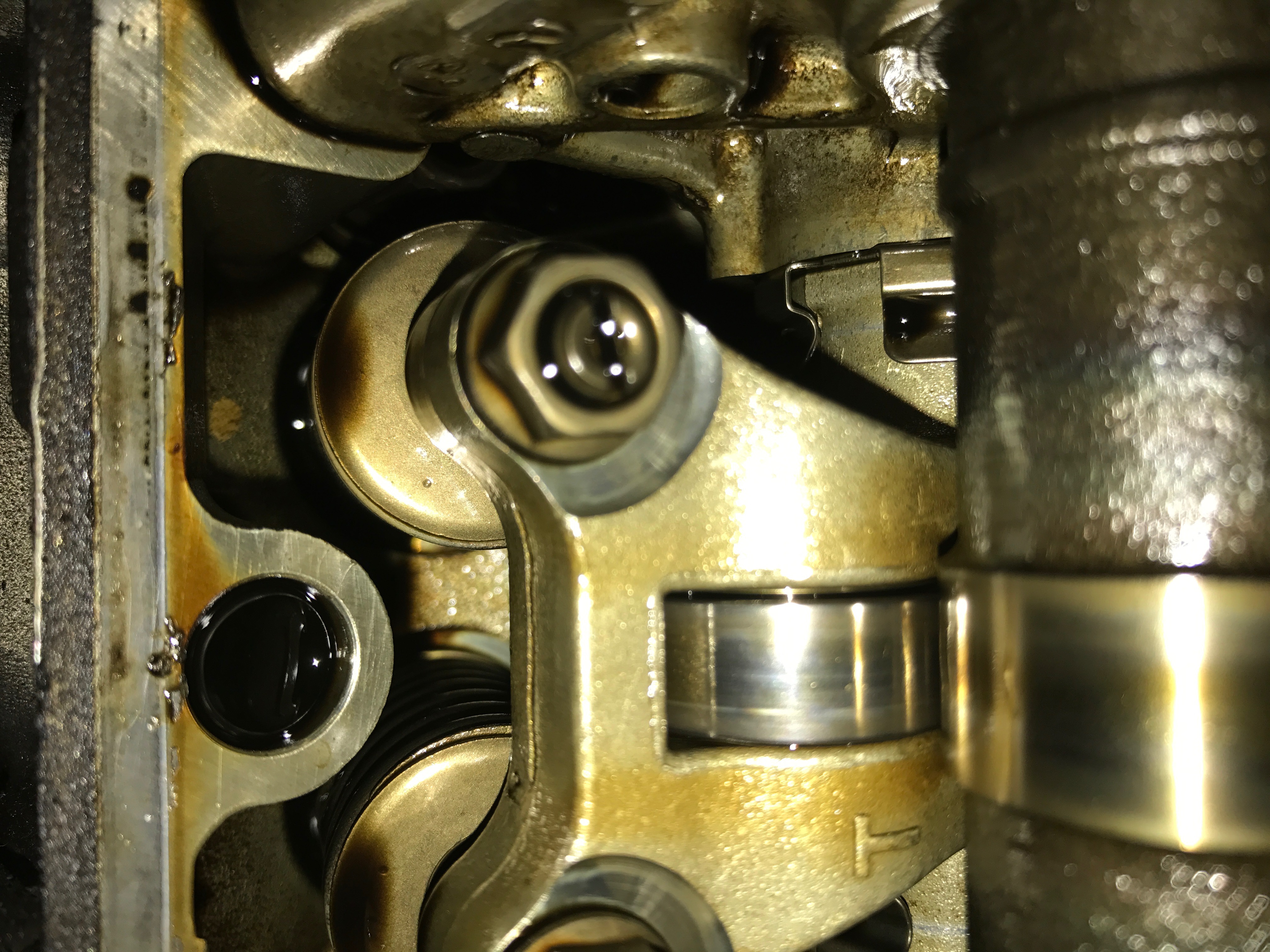

The exhaust cam on the other hand shows wear on every lobe (see pic) but the rollers do not have any damage at all.
My question is
- is everyone in agreement that the head needs to be replaced? Or?
- since the car was running good prior to the timing chain, should I just change the chain and leave the cam alone?
- should I replace the cam?
- if so, can I replace just the one. In other words they don't need to be replaced as a pair.
- since there is no damage to the rollers, do I have to replace them with the cam?
Remember the car is 12 years old and has 330,000 miles. I defiantly want to watch my spending..

I took a look in the shop manual for your accord. There is a spec for the cam lobe height. The rocker arms have a spec for the diameter of the piston/roller bore.
I'd probably just replace the timing chain if this was my car especially since you have 330K miles. If the engine starts having issues, I'd probably get a low mileage engine vs repairing.
