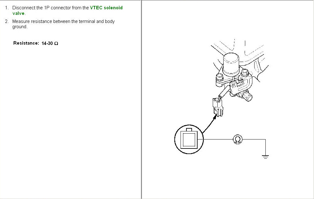

Old Jul 7, 2012 | 09:08 PM
Like Poorman212 stated, for P1259 the first thing to do is check for low oil level.
Here is some more info. on diagnostic, although some of the steps are specific to using Honda diagnostic equipment and software.
You can do the resistance testing (e.g., ohms measurements) easily with a multimeter.
1999 Accord P1259 Troubleshooting
