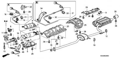

Looks to be the catalytic converter lower or upper cover. #5 or 6 in the parts diagram.
Attached Thumbnails Part detached/need help figuring out what it is-exhaust-pipe-l4-465481.jpg
Old Sep 30, 2013 | 07:00 PM
I'm with redbull, cat cover. Some places can will just intall a hose clamp over the cover to get it back in place......do not let the shop tell you you need a new cat, big money.
At a shop, I'd call that ~ or less than a $100 fix.
