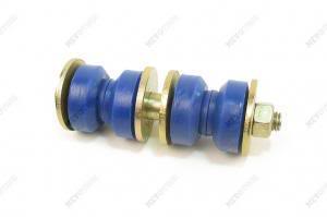

well, i guess its the other end. The end closer to the wheel. The one with like one bolt and 4 rubber bushings. I guess the end links.

Yeah, they're technically called stabilizer end links. Way easier to do, just hold the bolt with a wrench and ratchet away at the nut. The washers should have thedomed endsfacing each other and the bushing have metal in the middle of each pair.

That's the one. Mine had washers with a domed side on them...
