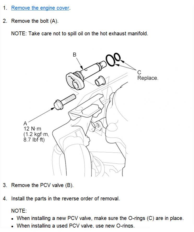

Hi,
I just registered and can't get the site to open ... Hoping you can pinpoint the exact location of the PCV valve on wife's 2010 Honda Accord 3.5 V-6. I've been looking all over the net for an answer. I even went on-line and purchased a Haynes manual for this reason, but it only has words about "this hose and that hose", with no definite location. It does show 4-cyl pictures, but nothing for the V-6.
Thanks in advance.

See attached image.
Attached Thumbnails PCV valve on wife's 2010 Honda Accord 3.5 V-6.-8th-gen-accord-v6-pcv-valve.jpg
