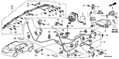

The SRS floor wire harness is one large separate harness. Part # 6 in this image.
SRS floor harness part # 77962-TE0-A11 for LX, MT, list price is $111.75
SRS floor harness part # 77962-TE0-A01 for LX, AT, list price is $111.52.
Many Honda dealerships do have terminal repair kits; but, due to safety and liability reasons will not repair SRS harnesses. They can and will repair other types of harness terminals.
