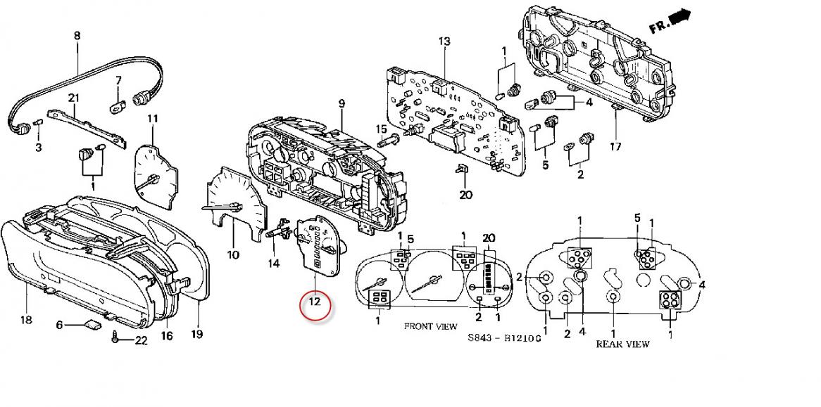

Since it is not overheating, the temperature sender has been replaced, and the gauge moves from tap on top of the dashboard; then it may be a loose connector, wiring, or just a faulty gauge. The temperature gauge retails for $94.65 from Honda and around $68 plus shipping from an internet Honda dealer. Honda part number 78130-S84-A21.
You can try to get a used gauge from a salvage/junk yard or through ebay. The part is separately replaceable, see attached picture.
This link has instructions on removing the instrument panel. You do not need to follow every procedure in the link, since you are not replacing the bulbs.
