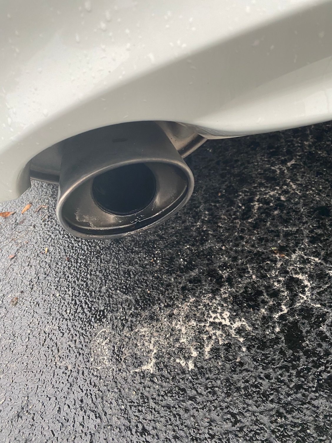

Who does your oil change? Could it be that not enough oil was put in to begin with. Have you checked your spark plug tubes? With that much oil gone you should see something unless the valve stem seals are leaking. Do you have smoke coming from tail pipe when idle or driving.

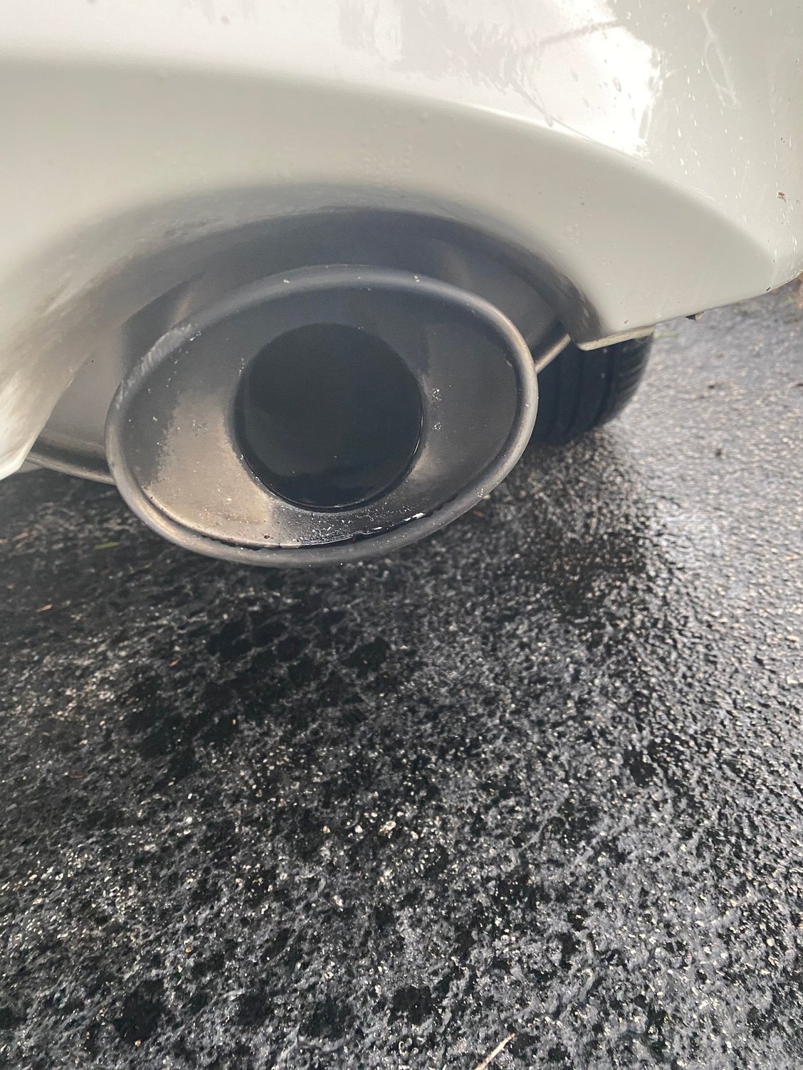

Is your V6 an automatic or manual transmission? Do you notice black soot on the exhaust tip?
Many 8th gen V6 with AT were known to have excessive oil consumption.
Many 8th gen L4 were known to have excessive oil consumption.
Not everyone experienced it; but alot. Honda had extended warranties which expired for most 8th gen Accords; due in part to lawsuit settlements. The real fix was to replace the oil control rings on the pistons.
these are pics of my exhaust tips, just darkened, not much soot. It’s wet because I’m in Florida and it was just pouring.
