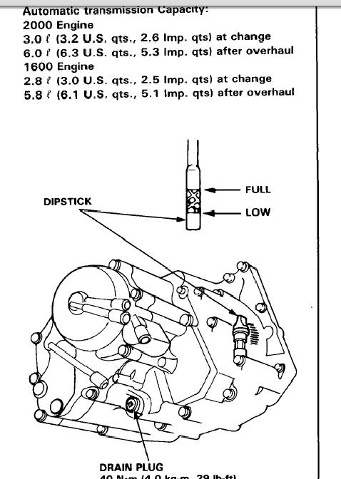

Suggest you look at this thread and download a manual for the car : https://www.hondaaccordforum.com/for...threads-40780/
The check of the fluid level (? - I thought you did this), is done when the trans fluid is warm/hot and within one minute of shutting the engine off.
The fluid change is a "drain and fill". There is not a filter (there is but you'd have to tear the trans into pieces, rebuild to get to it) that is changed.
To drain and fill the trans. You will need a 3/8 ratchet, long funnel and the new fluid (3 qts) and a drain pan.....some will suggest a new washer for the drain bolt but they can be re-used a few times.
If you have never done this before, I suggest you do it this way. Park the car on level ground. Jack up the right/pass side of the car, be safe!. Remove the right/pass side front tire. From the wheel well look at the "end" of the trans case, you will see a round bolt with a 3/8 hex in the middle. Insert the ratchet into the hex and remove the bolt - hope you put the pan under it .
While it is draining, clean the "gunk" off the drain bolt - there will be gunk on it, don't get worried.
Install the drain bolt back in and tighten (29 ft lbs by the book). Put the tire back on, lower the car......should now be sitting nice and level.
Use the long funnel and add the new fluid thru the dipstick hole - question is yours a threaded or "plug" dipstick, just wondering. I'd add about 2.5 quarts and check the level. If it looks close, start the car and let it run. While it is running and your foot on the brake, move it thru ALL of the gears a few times. After about 5~10 minutes of the engine running, shut it off and check the fluid level....adjust as needed. As you know, over filling is just as bad as under filling.
Sorry....that got long winded

If you think the PS fluid was getting into the tranny, you might want to think about another few (two) drain and fills on the trans. You really only change about a third of the fluid when you drain and fill. Suggest a "few miles" of driving between changes to mix the old and new enough that you are getting to where you want to be.
