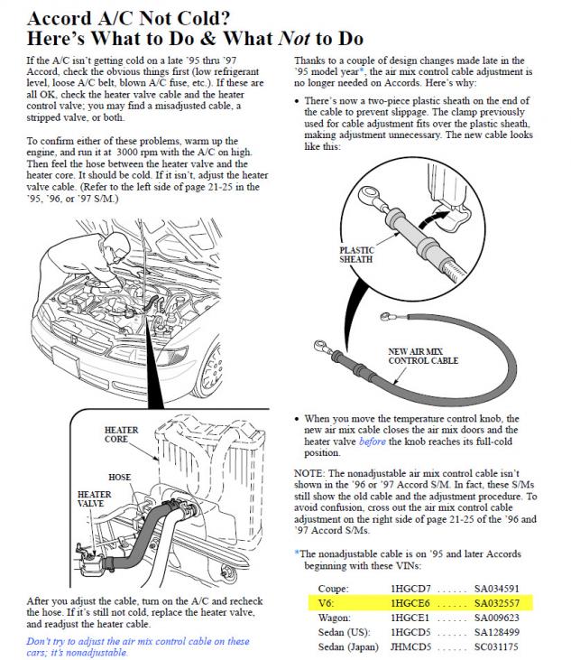

The 1998 Accord doesn't have an air mix control cable like a 1995. It has the air mix control motor with rods attached to the air mix control linkage.
In addition, only 1994 and early 1995 Accord had an adjustable air mix control cable; mid-year 1995, 1996, and 1997 (5th generation) Accords came with a non-adjustable air mix control cable.
https://www.hondaaccordforum.com/for...97-accords-jpg
I looked up the parts on Majestic Honda and they were the same part number for both years.

Look again. A 1998 has an air mix control motor, a 1995 does not.
Both cars have a heater control valve cable. However, a 1998 does not have an air mix control cable. The OP even stated more than once he has an air mix control motor.
