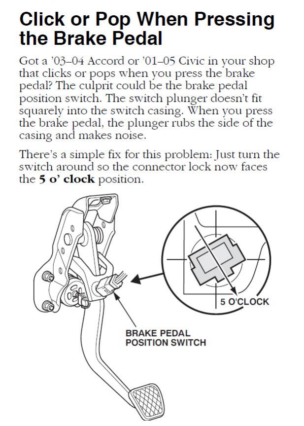

For the pops when starting or stopping, is that occurring right when you press on the brake pedal?
If so, that could be the brake pedal position switch. The switch plunger doesn’t fit squarely into the switch casing. When you press the brake pedal, the plunger rubs the side of the casing and makes noise. It can be adjusted. See attached image.
Even if the pop is related to the switch plunger, the rattle/soft knocking may be something else.
