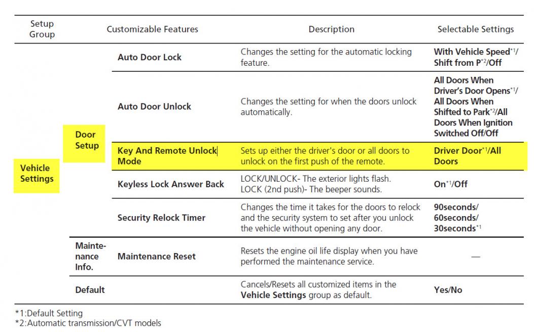

The default setting for the remote locking/unlocking is as follows:
Locking doors with the remote, press lock once, some exterior lights flash, all doors lock, and the security system sets.
Pressing twice on the remote lock button (within 5 seconds after the first push), a beeper sounds and verifies the security system is set.
With the remote to unlock: Pressing once, some exterior lights flash twice, and the driver's door unlocks.
Pressing the remote unlock button twice and the remaining doors unlock.
For a CVT, car has to be in Park to change the customizable settings. Check again to see if the setting for "Key And Remote Unlock Mode" was changed to "All Doors" after the first time you tried to changed it or did it still show in the default mode.
After locking with the remote, press the unlock button twice to look for the exterior lights flash and listen for the beeper sound. If the Keyless Lock Answer Back was turned off, it should not answer back.
