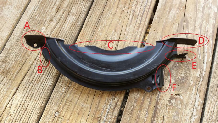

Resurrecting this thread -- for a 94-97 F22B1 engine.
Below is an annotated picture of the cover (from an eBay sale -- unfortunately mine is still on the car).
I removed the three 10mm bolts at A, E, and to the left of F ... after which the cover could slide left-to-right about 1/4" or so, and I could drop the left side down maybe 1/2". But the cover does not seem to want to dislodge.
I'm guessing this cover is removed in order to get to the two transmission-side oil pan bolts, and that we do not have a chicken-and-egg situation here. The question is, how does that cover come off? I tried sliding and jiggling for a few minutes but could not find a position that would allow it to come out without potentially bending the metal -- which I'm guessing you should not have to do. However looking at this photo, it appears as though they did have to bend the metal.
Has anyone done this? If so, can you please describe how? I've annotated the various tabs on the pictures to make your description easier.
Thanks. John

As referenced above, it sounds like the easy solution is to remove the shift cable cover and that will unblock the tc cover from falling right out. Here is the pic again from that thread, I've annotated the tab from the shift cable cover that is blocking the TC cover from removal.

You do not have to remove the oil pan. It is a matter of of sliding D towards A in your picture. Then rotate the cover counter clockwise while gently pulling towards the rear and slightly down. If there is an excess amount of corrosion and debris then you may have to remove the oil pan, but otherwise I have never had to remove the pan to get a transmission out of one of your generation Accords.
I guess the question becomes why are you taking it off? Are you pulling the transmission? If so loosen the transmission and the cover should come right out, but remember to put it back in place before bolting the transmission back in place.
