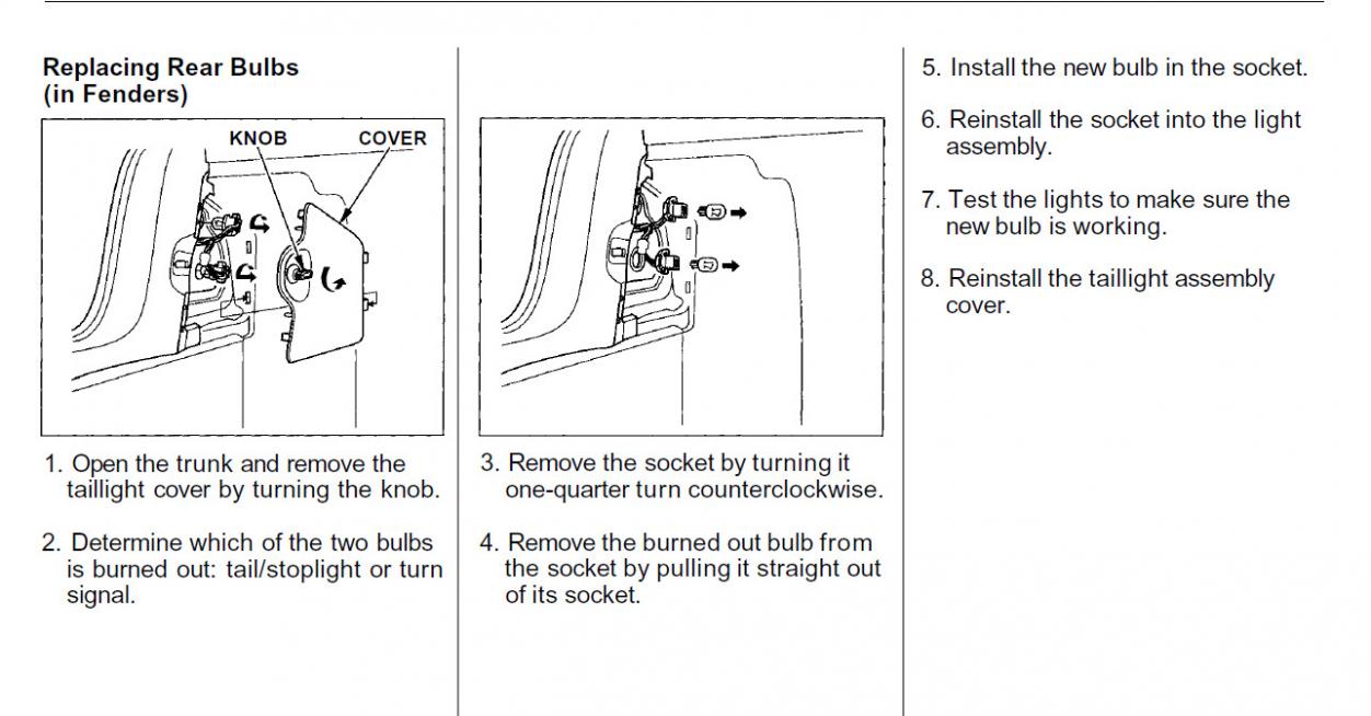

I drive a 1997 Honda Accord EX Sedan (not station wagon - not sure if that makes a difference) and my brake light on my passenger side blew out. I bought a BP7443 12V light bulb and now I don't know how to replace it. I've searched the web and found instructions for years other than my own which is why I came here.

Welcome to the forum.
See attached pic. for instructions.

OMG! That was so simple. I just replaced the bulb. Thank you so much, you're the best!
