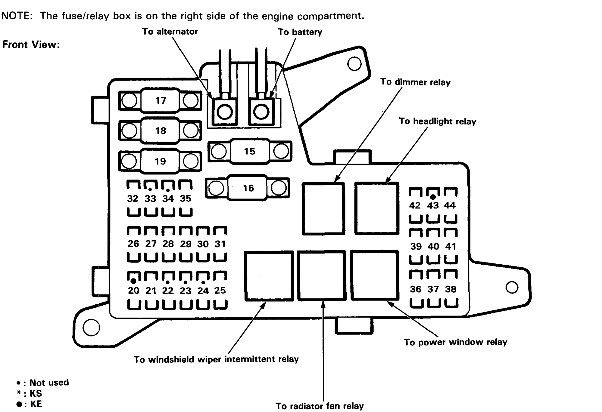

By the way do you know what Amp is right for the main fusible link on the fuse block? It is the one that the + from the battery goes to.
Mine was blown and a "handy" replacement was put in. I would like to put the right one in. I have seen them from 30 Amps up to 100.
Im OK with going a little higher then factory, but not by much. I don't want a car fire.

The fuse diagram under the fuse box cover should tell you. The owner's manual will have that info too. I think you can get the pdf of the owner's manual from honda online.
Definitely use the amp rating for the fuse recommended for your car. Even going over by a bit risks a fire and isn't worth it. If that fuse is blowing due to an electrical fault, you have a serious short in your system.
Which fuse is blowing?
