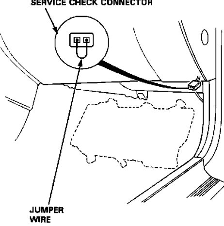

need to find out what the code is and report back.
jump the diagnostic connector under the pass side dash area.
codes 1-9 are short individual blinks, 10-43 are long and short blinks, long is the first digit, short is the second digit.
