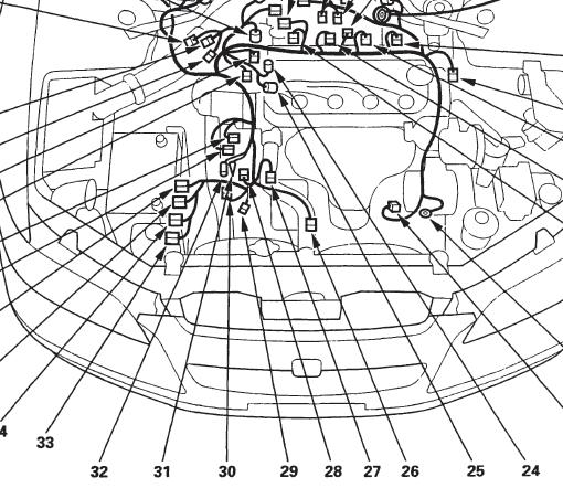

yes,thats correct. i'll take care of the tune up issues and see thr result. i'll check the connection also,are those the ones on top and mid-side?
Old Jan 24, 2012 | 06:29 PM
Sorry, best pic I got, a bit of an eye chart. Shift B is #28 in the pic.
Attached Thumbnails same problem, ecu not the answer for '98 accord-6th-gen-trans-connectors.jpg

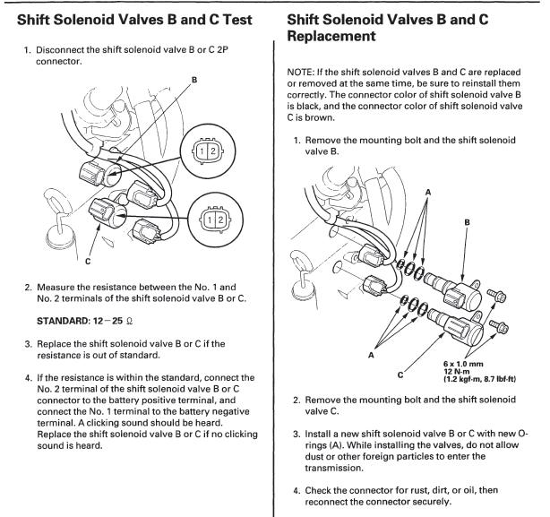

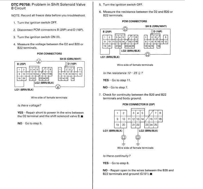

Got you message, figured I can post the pic's here better.
One pic shows the testing of the solenoid...note which on goes to the POS + and which goes to the NEG -...then the first page of the testing for the P0758 shows which pin is which.
Attached Thumbnails same problem, ecu not the answer for '98 accord-6th-gen-shift-b-c-tests.jpg   same problem, ecu not the answer for '98 accord-6th-gen-p0758-pg1.jpg
