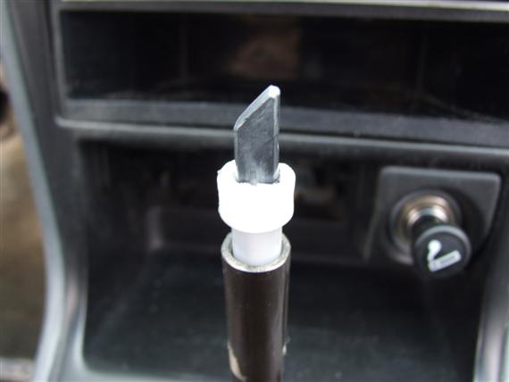

It could be a problem with the shift ****. In this link, at step #11, this is the part that needs to be pushed down, your shift **** may not be fully pushing it down.
