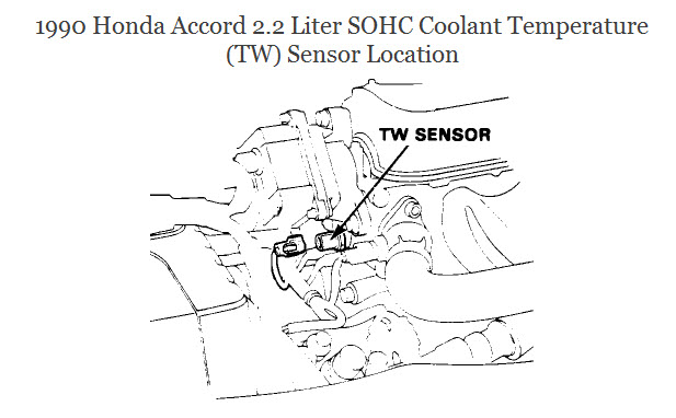

On your generation Accord, only certain things can cause the ECU to put the car in limp mode.
Some of the symptoms you describe point to input from the TW sensor (also known as the ECT sensor) circuit.
Sounds like you may already have changed the TW sensor. This would start pointing to a problem with the thermostat or a faulty replacement TW sensor or circuit from the TW sensor to TCU. There is also the possibility it is the TCU. Your model year Accord has separate ECU and TCU (Transmission Control Unit); both located under the passenger side footwell. Your model year Accord was known for problems with the TCU such as blown capacitors and/or burnt resistors in the TCU. You can pull out the TCU and open it up to inspect.
So to recap: thermostat, TW sensor, TCU, and wiring would be the things to focus on.
See attached pics. (one of the attached picture looks like a thin black line; but, has info. in it) and links.
Honda Forum : Honda and Acura Car Forums - View Single Post - limp mode, limp home mode etc...
CB7Tuner Forums - View Single Post - Automatic Transmission FAQs
Attached Thumbnails Shows HOT and Not Shifting-thermostat-tw-sensor.jpg   Shows HOT and Not Shifting-tw-sensor-location.jpg
