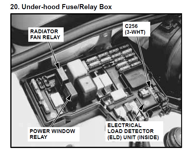

With the ignition switch to ON, turn on the A/C, does both cooling fans run?
If not, we can step through some other things to check.
Old Aug 27, 2013 | 09:19 PM
1994-Texas-LX's Avatar
Joined: Aug 2013
Posts: 23
I think you meant "start the car" (correct)?
When I turn the Ignition switch to ON and turn on the AC no fans come on.
When I start the car and turn on the AC, the fan on the drivers side of the radiator comes on
Old Aug 27, 2013 | 09:33 PM
Yes, with engine running and A/C turn on, both fans should run.
Your radiator fan is not working.
1. Check Fuse 21 (20A) located in the under-hood fuse/relay box.
2. If fuse is good, swap the power window relay with the radiator fan relay and see if it makes a difference. See attached pic.
3. If radiator fan still doesn't run, check the fan motor by applying direct power and ground. This may be a little difficult to do, as the connector plug for the radiator fan is located near the bottom of the car. In addition, the plastic splash shield at the bottom of the car gets in the way when you're under the car.
Unplug the radiator fan connector and apply direct 12 volt power and ground to the connector. See linked pic. This way you can tell whether the fan motor is good or bad. You can use long wire just as speaker wires, etc. to run from the car battery or if you have a 12 volt lantern battery lying around, that works too.

Old Aug 29, 2013 | 09:57 PM
  #17
Joined: Aug 2013
Posts: 23
Redbull-1
Thank you your help
I removed and tested the fan and it did not work, turns out it was stuck.
I cleaned it up a bit , gave it a push and it ran after that with no problem
Also your tips of the bleeder valve etc worked because all seems to be good now , no overheating
Thanks :-)
