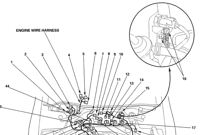

Check and clean the battery connections. Also check the main ground on the end of the tb to be sure it is clean and tight, #16 in this pic.
Attached Thumbnails Speedo Tach and intermittent Starting Issue-6th-gen-g101-loc-4cyl.jpg
Already cleaned the battery posts. I'll check the ground you mentioned. I was pulling on all the harnesses and everything is good for the moment. The temp controls are going on and off now but weren't working at all recently. Seeming like a short or bad ground somewhere. I had a multimeter on the battery as I pulled on cables. I pulled on cable going to fuse box on drivers side and voltage dropped and then everything started working. Now I can't duplicate that voltage drop. I hate intermittent electrical problems! I am getting no codes at all.
