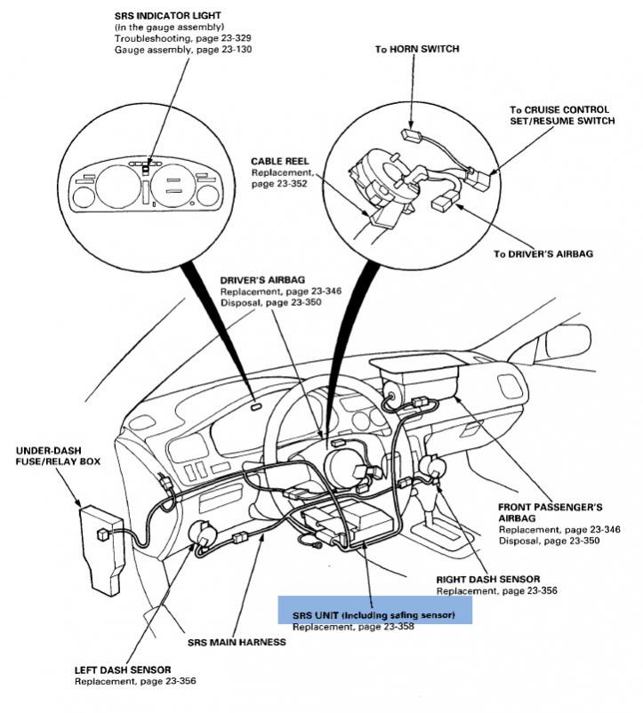

Here's some pics. showing the separate modules. To clarify, the trouble codes for the separate modules can be retrieve from the same 2P Service Check Connector.
Attached Thumbnails SRS/CEL OBD 1 stuff... any thoughts or suggestions?-ecm-tcm.jpg   SRS/CEL OBD 1 stuff... any thoughts or suggestions?-srs-unit.jpg

A SRS code 5-1 means that there is a problem with the SRS computer. The lifetime warranty is on the seat belts, not the air bag system. It is likely that you would have to replace the SRS unit.
