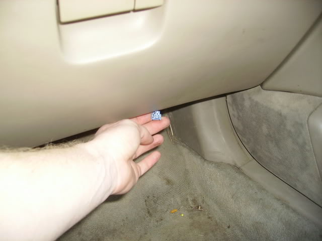

Old Nov 12, 2007 | 04:43 PM
caverspencer's Avatar
Joined: Nov 2006
Posts: 15
Default RE: SRS light
Thanks for all your input so far.
I ran out and took some pictures. Please excuse the messy car.
So if I jump the Blue connector shown will it by chance show the codes? If so where do I find a list of what they mean?

Old Nov 12, 2007 | 04:49 PM
sir_nasty's Avatar
Joined: Feb 2006
Posts: 6,290
From: Montana
I'm just guessing but I looked at a few other threads, it appears that the blue plug does work for diagnostics as well.
Old Nov 12, 2007 | 05:07 PM
nafango2's Avatar
Joined: Aug 2007
Posts: 1,110
btw you must be going crazy nasty. ALL U.S. cars 96+ have OBDII, its a law.
and yes, the blue plug does work for diagnostics, just jump it with a paperclip, turn the key to ON, and count the D4 flashes.
