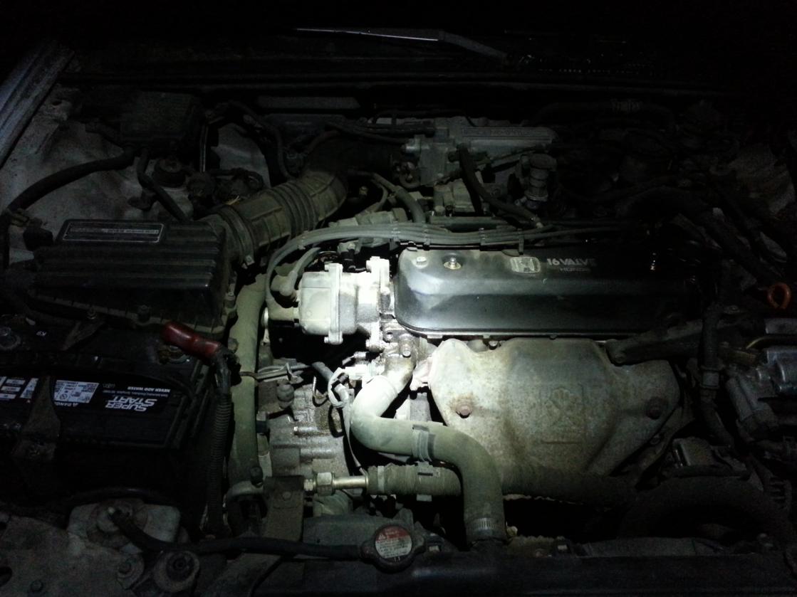

Also, there is an oil leak, possibly from the head gasket, possibly from something else that I need to diagnose and fix. The majority seems to be coming from the left side of the motor and a lot had dripped down around the starter. Maybe a picture would help?
Also, on the dip stick, kind of far up it there is a burnt oily type look. Does this mean anything in particular? My best guess on this so far is that it was run somewhat low on oil and got hot? I say this because I have read this elsewhere and the guy that had it last said he had to add oil regularly (I actually think he had to add oil because of the leak not because it burns it)

1 pic
