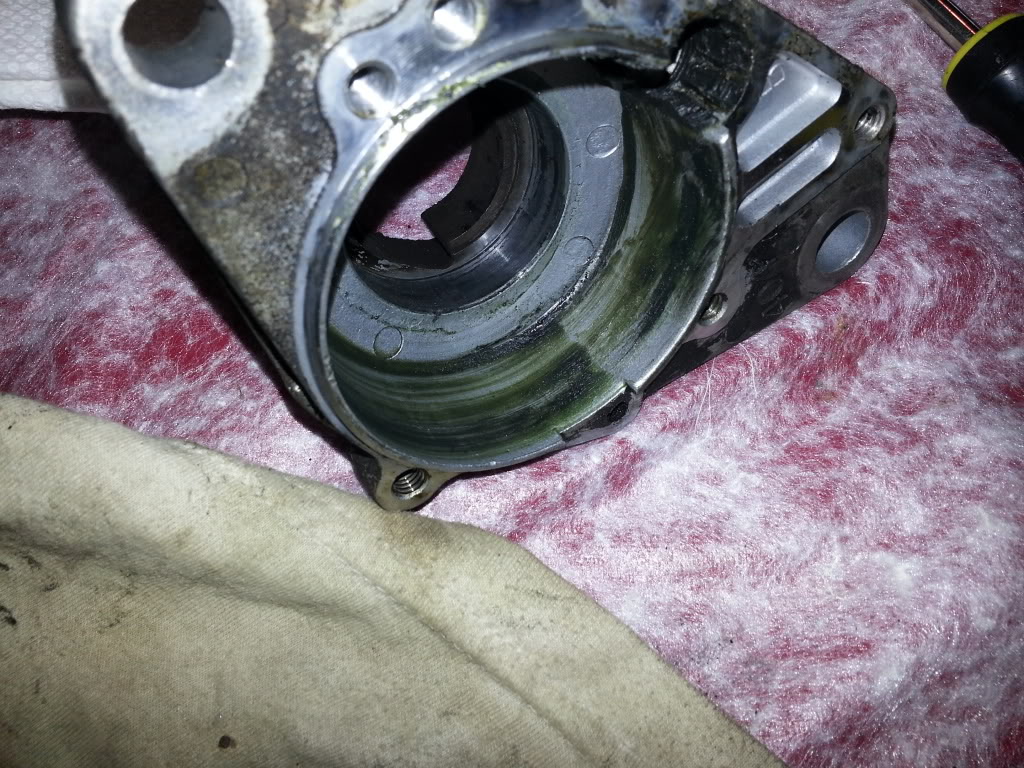

I am guessing I need to clean all this gunk/lube out of this area of the casing?

I am guessing the green goop covering the screws should stay. But what about the other goop all over the forks there. Should I clean it up and replace with white lithium or wheel bearing greese

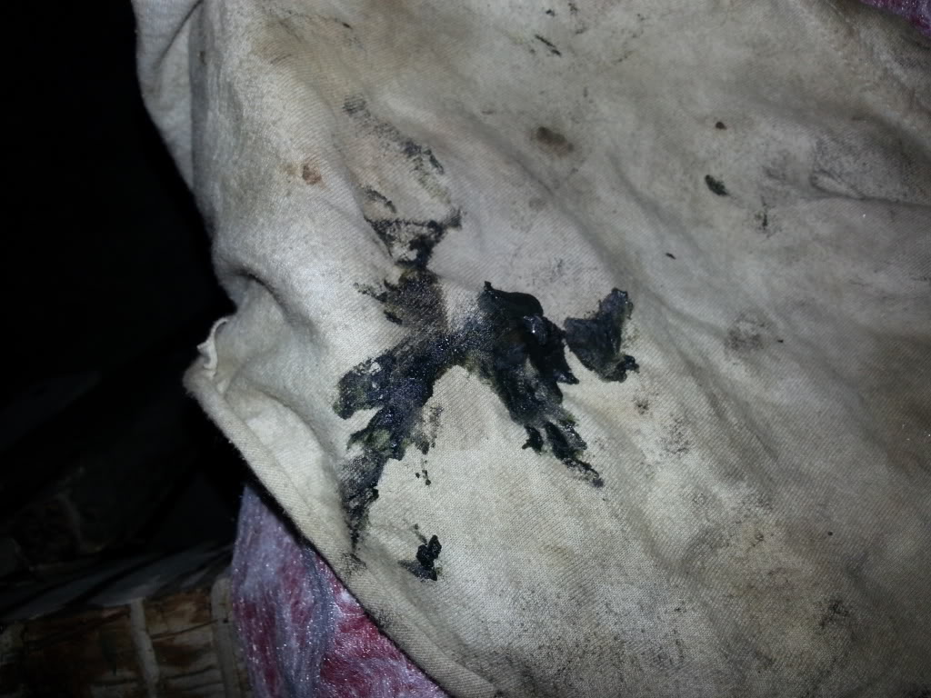

Heres a pic of some of the greese that came off the casing
Size:  134.5 KB[/QUOTE]

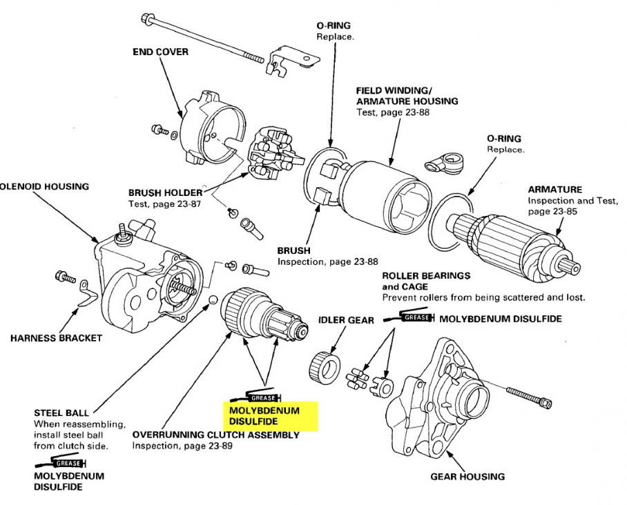

See attached images regarding inspection of the overrunning clutch assembly and greasing the gears with molybdenum disulfide grease. These pics. are for a Denso brand starter on the 5th gen Accord; but, should be the same as a 4th gen Accord Denso starter.
If that is a Denso brand starter, you might also check the condition of the contacts. A search on the internet will shows various places selling the contacts, etc.
Rebuild your starter for less than $20 - Team Integra Forums - Team Integra
