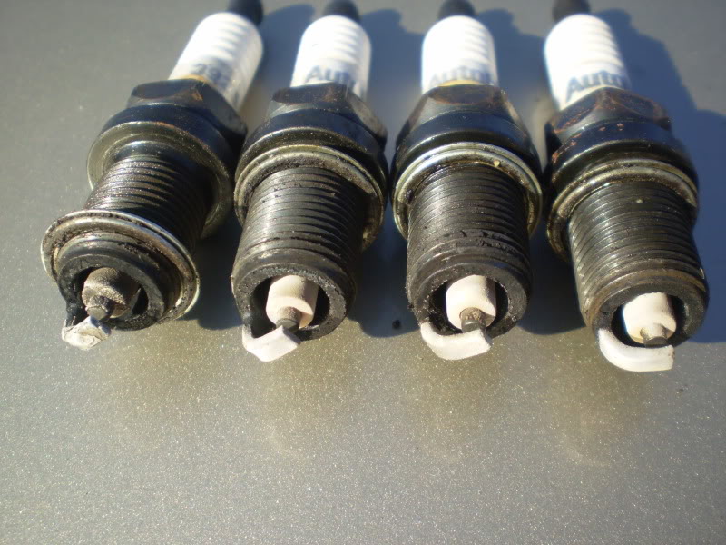

The plugs look exactly like this... my exhaust valves are the same color white but I think thats normal from what ive looked up

Is that pic of your plugs or one you found as a reference?
Old Mar 2, 2013 | 08:43 AM
  #45
RobinsonRicer's Avatar
Joined: Mar 2012
Posts: 731
From: New York
Found as a reference. But the three on the right are exactly what they look like

That's not the greatest pic to read plugs; too far away.
The ceramic surrounding the electrode should be very light tan. It takes several hundred miles for plugs to color in a normally running engine.

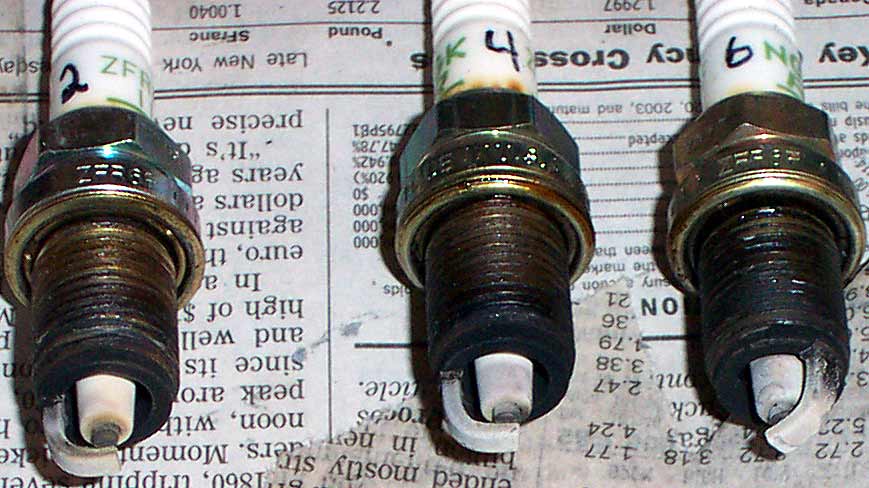

Thats exactly what they look like. Just white. Not tan. And its not deposits of anything, just white color. And Ive had these plugs in for maybe 6 months.
Could they have anything to do with this issue? At one point I did have issues with a lean system but that was resolved. With the white coating on the plugs could it be possible that they are causing the issues?
Looking into it though it seems like that should be normal, to be honest, Ive never seen spark plugs with tan tips on my car, theyre always snow white, no hint of tan.
heres another reference pic, exactly what mine look like but ill take a pic of my actually spark plugs once i get back outside

The plugs in the latest pic aren't white. #2 is very light tan, #4 is very light gray/tan; both indicate a normally running engine. #6 looks like it ran hot.

2 I see, maybe its my eyes. I dont see any tan in my own spark plugs. But based on what you're saying it looks as if my engine is running hot. Or at least was.
Would it be a good idea to change the spark plugs if theyre white like that then? Or is there the underlying issue still?
