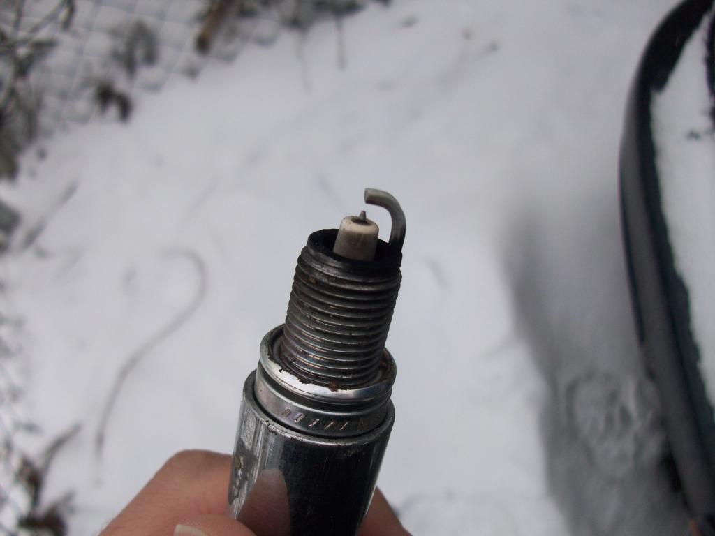

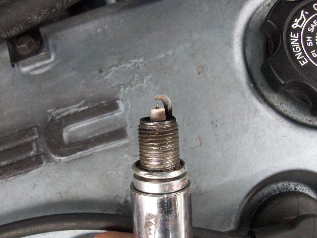

here are some pics. Its freezing out so I only took one spark plug out but they all look exactly the same. I do see a little tan in the photos but in real life its more white. The black stuff around the plug is not as pronounced in person than in the picture but I dont know if that indicates something. The more I look into this, the more it seems like my timing is a little too advanced. But because I use premium, there probably wont be any knocking. Does a timing problem seem plausible?

The plug looks fine. When you pull the others out to take pics, get much closer and take the pic from the top of the plugs so most of the electrode porcelain is visible.
OBD2, the ECU controls the timing; no manual adjustment is possible.
What's the fuel pressure?
