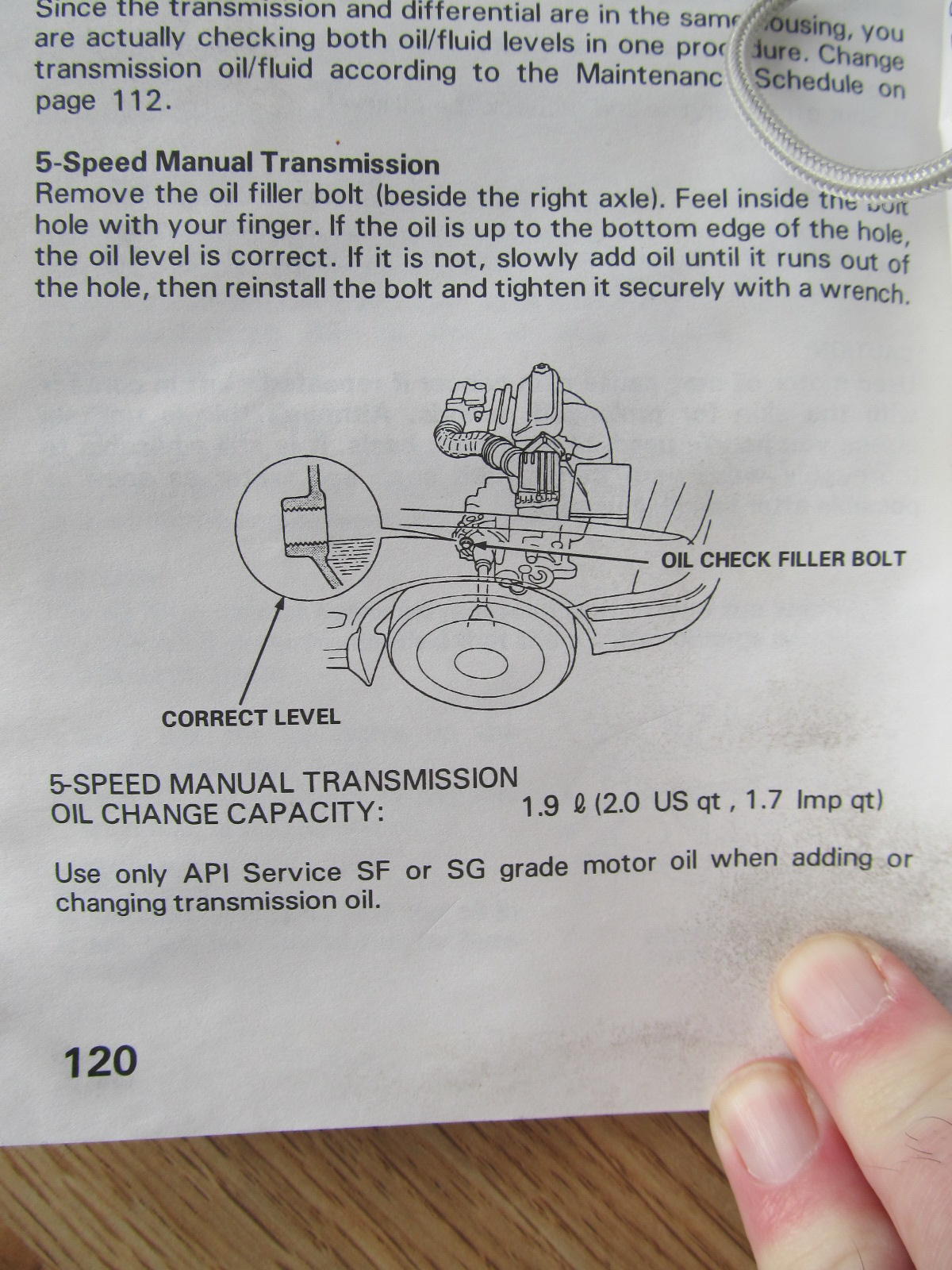

and how to check it...
Old Dec 24, 2011 | 03:05 PM
UhOh's Avatar
Posts: 908
From: Washington State, USA
Originally Posted by UhOh
A fill plug, socket not fit; all fluid goes in here - until it dribbles out.
Fill plug has a negative 4 sided hole that the ratchet itself fits into, no sockets.
can't recall what this is called - dumb me, help.
also possible memory wrong here since I also have a Nissan MT and I could be confustigated between the brands...
