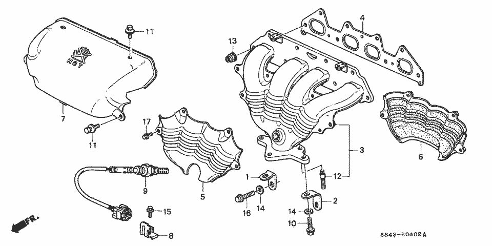

The F23A4 engine is ULEV-VTEC, and I think it's in some of the California spec cars. It has a different exhaust manifold & distinctive ribs across the heat shield like the attached picture.
