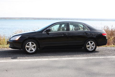

I have a 2003 Honda Accord 4 cyl with 212,000 miles on it. No problems at all, just normal maintenance. Any problem switching to synthetic motor oil? Good idea? Thanks for you suggestions.
