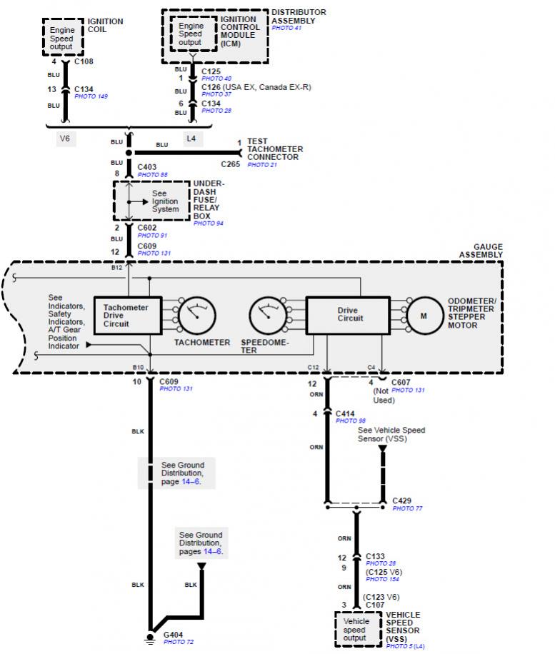

The tach gets the "signal" from the ICM...at least in the 4 cyl 5th gen, the 6 cyl might be different.
If the engine is even and it is just the tach...there might be something with the wires or the drive circuit.
What do you know about the history of this car?
Old Jan 10, 2013 | 07:45 PM
Posts: 7,101
The V6 is different. The tach gets it's engine speed output signal from the coil.
Old Jan 10, 2013 | 08:27 PM
Difficult to test for, so you rule out everything else (like flaky wiring connections) then replace the coil. I'll try to find an old thread about that.

I'd be looking for flaky wiring connections, anywhere. Maybe RedBull has enough drawings to point out the ground connections that are related to the tach circuit. Ground points are suspicious for corrosion.
I don't know where G404 is physically located, but also check the tach-signal wires coming off the coil. If the collision was anywhere near the interior fusebox, there might be loose connections there.
