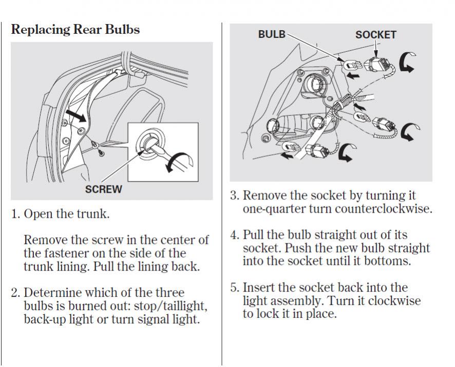

So how do I replace a taillight bulb on a 2012 accord?
Thanks.
first, lose the attitude, second, alot of guys here have those "pos" cars with 300k on them they need to keep running.
open the trunk and remove everything that doesn't look like a tail lamp until you get to what looks like a tail lamp...then reverse procedure.
It's shown in your owner's manual. You can also register at America Honda's website for the owner's manual info. on your car.
Attached are the instructions for a 2012 Accord sedan, coupe shouldn't be much different.

Okay, so I was half trolling and half pissed that google wouldn't yield any relevant results. I hate the stereotypical honda ricers and just assumed you guys were the same. So I'm sorry for insulting you and your cars. Ironically, my car is twelve years old, has 180 something thousand miles on it, and won't stop misfiring. I know how to work on my car, I just gave my mom's (the accord) a quick look, didn't see those little plastic screws in the dark, and was like WTF.
