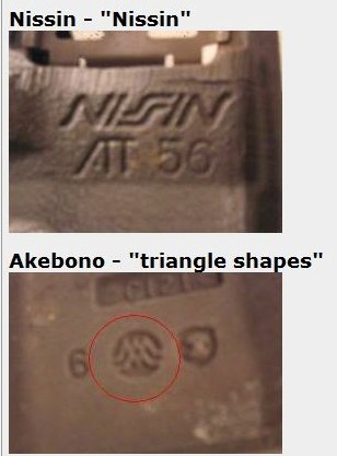

Default Images that show the difference between Akebono and Nissin brake calipers
Here are some screen shots I took from another website forum that shows the difference between Akebono and Nissin brake calipers. Just in case anyone else needs to know the difference.
