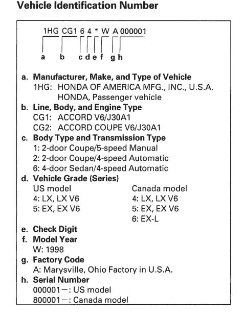

Well I'm no auto-trans guru so I can't really help. But I know the first thing anyone wants to know is whether this is a V-6 or 4-cyl. Completely different transmissions, & they may as well be completely different cars.

uuuhhh im fairly certain the only EX they made was the 4cyl. but to be more specific its the f23a4, the ulev, even though the tranny is the same for the f23a1 and a4

Well here is a bit of info to start with....see pic.
The only Honda Auto Trans that "suck" are the 98-02 Accord's.......the 5th gen is over 380K on the original one. So they don't "all suck". I've had other Accords with well over 200K and auto and never an issue.
Now to your issue, whaen was the fluid last changed and what fluid was used at this change?
