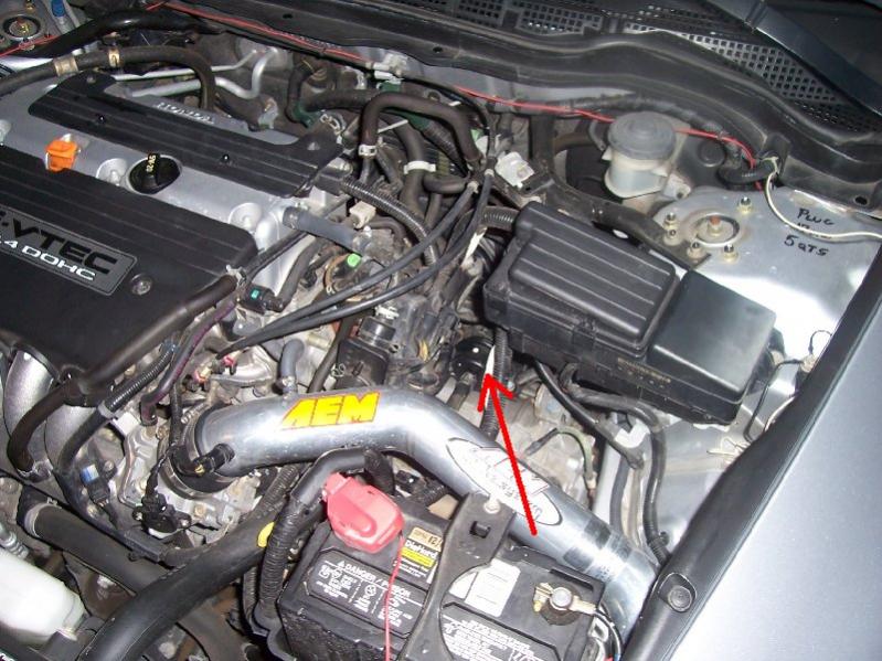

The feeling I get, and I'm no expert, is that things change over the years on these Accords. I have an 03 4 cyl EXL, which was the first year of a major design change, and it is a totally different car than the 02. So, I'm sure yours is very different.
For some reason, after some research, I found this filter sitting on top of the trans. case, is one of the cooling lines, and I haven't found anyone that knew it was there! I find that interesting. Now I know it's there, I can change it now and then.
LVP

I also have the 2003 4 cyl. I see that there is a filter? What is the part number and how hard is it to change?

to shed light on the inline trans filter........it comes as a Kit with the REMAN transmissions.

Talking about #4? Majestic has it for less than $15. Maybe $20 at your dealer??
Looks like it's just a bracket & a couple hose clamps.
