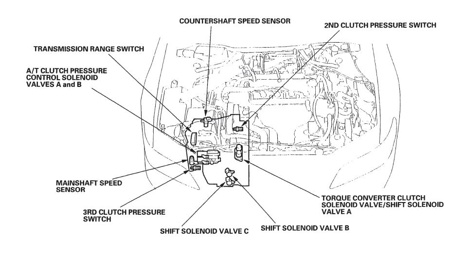

Is this a 4 cyl?

Poorman's picture is for automatic trans. Is that what you have?

well guys i did some more reserch and found out it is the 4th gear pressure switch that has a leak easy fix remove the battery and tray and wow there it sits no jacking car up or removing all the splash gaurds under the car to get to part 80 bucks with washer thx for you guys help hope this fx the tran leak
