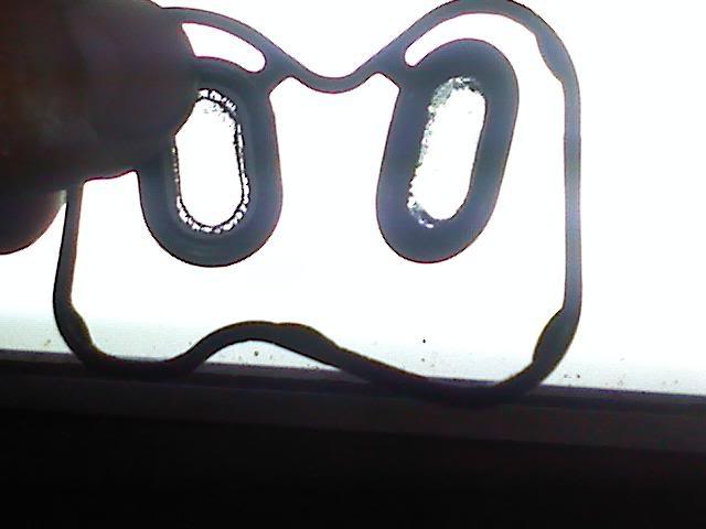

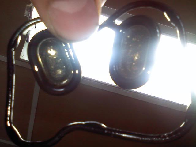

Checked the resistance of the shift solenoids. Either side of the plug to solid ground, I got 18 OHMS. Both sides of the plug to each other, I got 35 OHMS. I think one side of the plug is a ground, so I'm not sure why the difference, however spec is 12-24 ohms, and I feel comfortable that at least from an electrical standpoint the solenoids check out. I read about guys getting readings of 800-1500 on solenoids that had toasted.
I removed the solenoids to take a look at the passages to make sure they were clear. They weren't. The screens were about 80-90% clogged. I removed them, cleaned them, and re-installed. took her for a test drive and the transmission shifted nice and smooth.
Perhaps the clogging is normal on a car with 180k miles that's only had it's fluid dumped once, about 80k miles ago, I don't know. Perhaps it's a sign the transmission is grinding up. The particles were super fine, but they were at least somewhat metallic (I checked with a magnet). In either case, I believe that this was the cause of my shifting problems. Maybe not the root of my problems, but the immediate cause. Figured I would share in case others wanted to check theirs. They were very easy to remove and clean.
Here's some pics of the screens with my garage light behind it so you can see just how clogged they were. Also a pic of the bottom of the solenoids to give a frame of reference.
