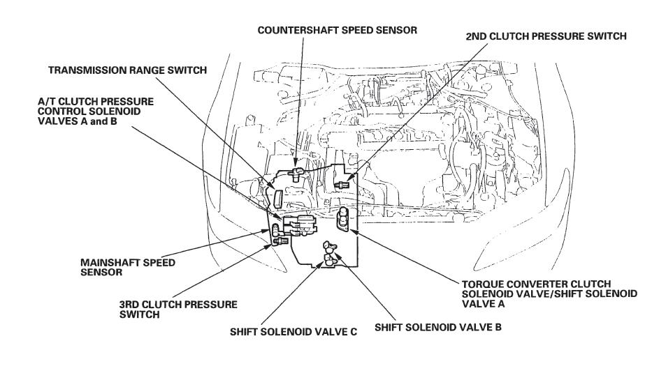

Hi I just purchased my car. No check engine light is on but I believe one or more of my transmission relays is bad. When its going from first to second gear it stalls but after that it runs smooth. Many people have mentioned the relays but is there any way of knowing which relay so I'm not guessing which out of the 4 relay sensors it is?
Old Mar 1, 2012 | 05:51 PM
When was the last time the trans fluid was changed and what type of fluid was used?
For the solenoids, shift C is listed for "flare" shifting in 1-2 upshift.
Old Mar 1, 2012 | 06:07 PM
MechanicLady's Avatar
Joined: Feb 2012
It was changed about a month ago with the original Honda fluid. I will check in to replacing shift C. Thanks for helping

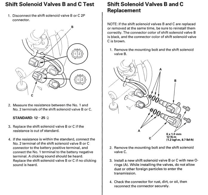

Old Mar 2, 2012 | 05:34 PM
Please TEST before replacing
Old Mar 2, 2012 | 05:51 PM
Joined: Feb 2012
How would I test it?
Old Mar 2, 2012 | 06:51 PM
Have a volt meter? Start with something like this.
And I holding onto hope, just so you know, the auto trans in the gen is kind of known for going bad.....but I like to hope for the best.
