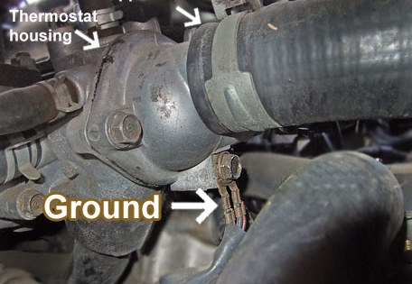

These aren't fun
There is a tiny, yet very important ground on the t-stat housing. Please check it to be sure it is clean and tight.
