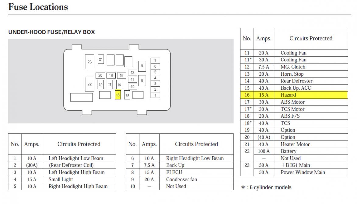

1. For the hazard lights issue, check the No. 16 (15A) fuse in the under-hood fuse box. If the fuse is okay, the hazard switch (which is the button with the red triangle) may need to be replaced. Replacing the switch is just a matter of gently prying the vent trim panel out, disconnecting the hazard switch electrical connector and squeezing the hazard switch clips to pop it out. Refer to Figure 9 and 10 photos in link on how-to-remove the vent trim. Disregard Figure 11 and 12 photos.

Attached Thumbnails warning lights clicker, driver seat moving forward-under-hood-fuse-box.jpg

1. I'll try to do that, any ideas where I could buy the clicker? (other than honda stealership). First I will, however, check the FUSE. thanks!
