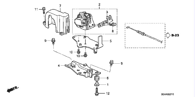

It would have been better if we had a video/recording from under the hood.
On your V6, under the hood at the passenger side firewall is an APP sensor (Accelerator Pedal Position Sensor). There is a cable attached to the APP, I believe if you slightly pull the cable, it will open up the throttle. Your 2005 V6 has drive-by-wire, so it doesn't have the traditional throttle cables on the throttle.
That way you can make the recording from under the hood instead of inside the cabin.
Then we can try to ascertain if the sound is from the condenser fan and/or something else.
