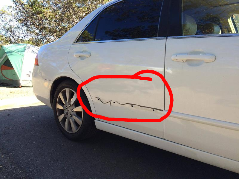

It fells off the right side of my car.
Or maybe it was stolen.
Either way I need a new one.
What exactly do I search for?
And where is the cheapest place to find it?
Thank you.

You should list your car year and model trim level.
However, that is the door molding. It is a dealer part. If the car color is Tafetta White, it should be:
Honda Part Number: 75303-SDA-A11ZDProtector, R. RR. Door *NH578* (TAFFETA WHITE)
Internet Honda dealers have lower pricing. You may want to double-check the part and color.
It is held on with clips and adhesive tape. You have to clean the old adhesive tape and area off before installation.

I'm sorry for omitting that information -- this is a 2007 Honda Accord EX V6.
I will double check the color on this, and if that is indeed the part then I will follow through and order online as you've suggested.
