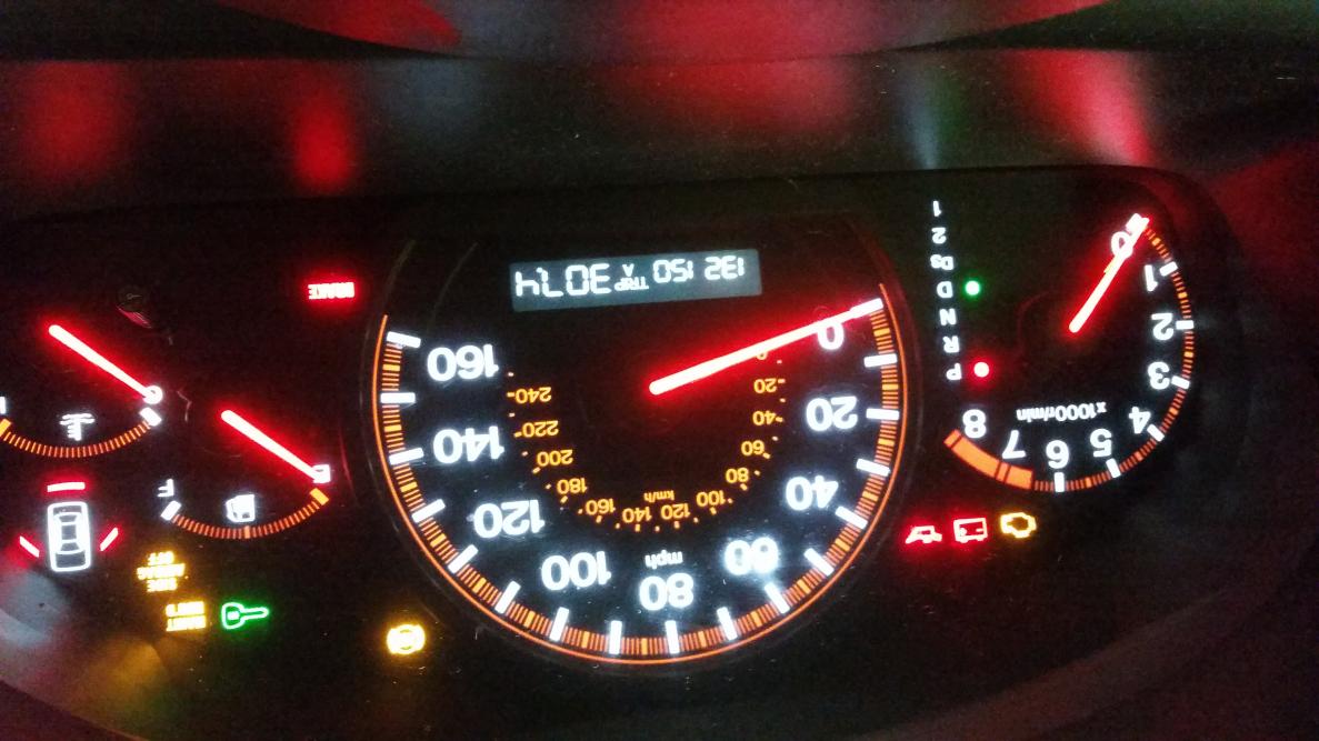

so i have a 2004 that recently wont start.i replaced the igintion switch in stearing wheel,still no start, i replaced the starter because it was making a horrible noise when trying to start (loud screaching horn)also heard slight buzzing sound from driver side kickpanelfusebox.) after replacing the starter the problem went away.when i replaced i checked wires and connections evrything looked fine. today i go and try to start it and you hear a slight click from under hood(i think starter, waitng for friend to verify.0 all lights on dash come on. none of the lights dim when attempting to start. you hear the fuel pump run. battery reads 12.51v when car is off. i swapped the relays under hood still nothing:co nfused:

Next, once you ge the car running.....I'd get the codes checked, you have some other issues going on as well.....based upon the pic....the cel and d4 are trying to tell you something is not right.
