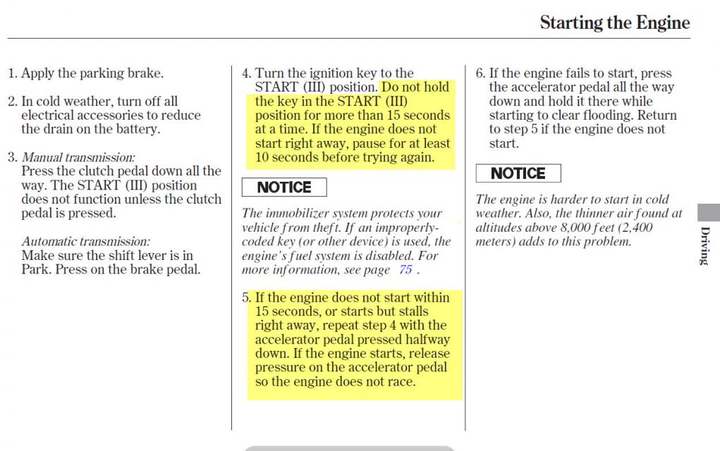

Next time it doesn't start, follow the instructions in the owner's manual (see attached pic.) and wait 10 seconds, then press the gas pedal down half way and see if it starts.
