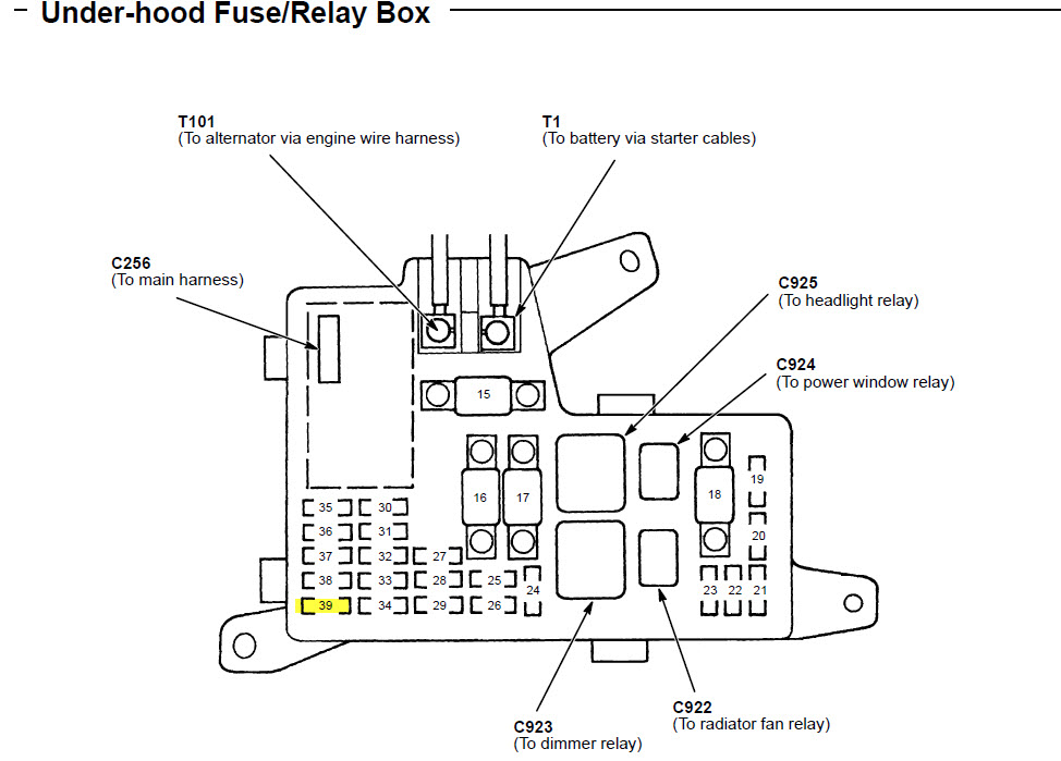

Sounds like you are losing your KAM (keep alive memory), you may want to have some diagnosis done before you through a PCM at the car. Do any other systems reset like the radio for instance?
I'd make sure I had good power and grounds at the PCM.
I don't see anything in the diagrams for a specific fuse for PCM memory.
Old Mar 21, 2016 | 12:33 PM
Under-hood fuse no. 39 (7.5A) is the battery back-up memory fuse.
Ah...thank you Redbull
