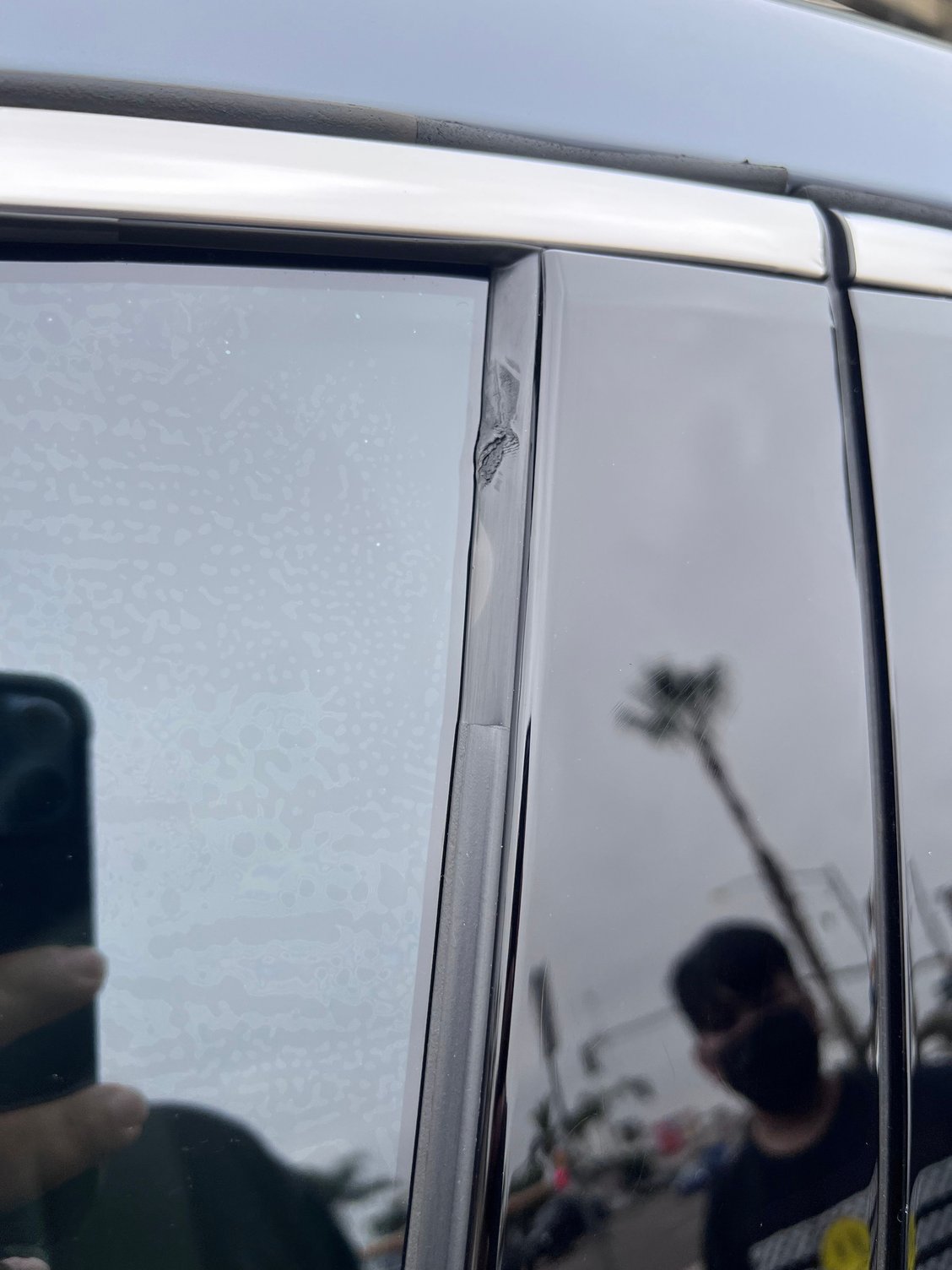

Needing the part for this exterior rubber molding. Just got my my tints redone today for warranty and the person was working on it burn my exterior rubber molding on the driver side. Need help for the part and is it hard to put on or not. Or the window glass need to come off. Please help asap here is the photo of the burned exterior rubber piece see photo below.
Here is the photo that the tint shop burn with the heat gun while my car is getting tinted. This is the second time I came back already for them to redo my tint and now they did this to my car.

That part is not critical for the function of your car. Just keep an eye out for water inside your car near that door incase this is causing a leak, but I doubt it will.
The site I look up parts is hondapartsnow.com.
Is this on the front driver's door? They don't have 2022 parts listed, but for the 2021 accord, I think the part is: 72271-TVA-A01 Sash, L. FR. Door Center (LOWER)
The other item it could be is the rubber weather strip the glass seals against. Maybe a picture zoomed out more from the outside and a pic looking at the edge with the window rolled down.
You may want to stop by a dealership to find out what part it is. The process will depend on what part needs replaced.

I also have to wait till the tint cures. But yes your correct the seal didn’t get burn on the side I got burnt in the middle of the rubber piece. And yes I would need to stop by the dealership in the morning to check part. But isn’t this just a insert that you don’t have to take the whole glass window out.and this is also on the front driver side here is the closer picture.

If this is part of the rubber molding that the window seals inside, then the glass would need to come out. It isn't terribly difficult to remove.
If this is just a rubber molding on the side, then some trim may need to be removed to get to that piece.
I'm just not 100% sure what part is damaged by using the parts site diagram.

Yes is just the outside trim that needs to be replace not the inside trim. This trim molding is by the gloss black pillar on the driver side.

I am not sure if the window has to come out but could try sourcing part from recycle yard....
